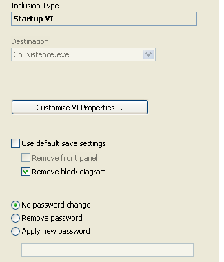

Dear TonP,
But that option u told was disabled by default. see here..... Yes am using LV8.5

You're showing the dialog for the Startup VI. The front panel of the Startup VI can't be removed.
Edit the properties of the SubVI (doctor.vi).
Vow.... That's the trick. Good catch dan_u....
It WORKED.
Thanks a lot.....
