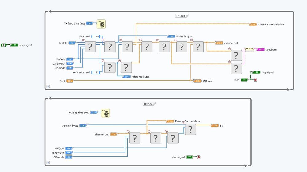

        When I open the OFDM(tx,rx).7z archive, I am missing a lot of modules, such as M-QAM modulation, can you tell me where to find this example? Or you can send me a complete file archive. I would be very grateful ofdm1.JPG!
