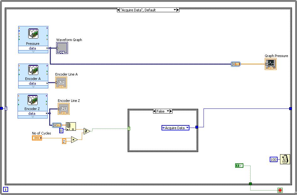

I need some help. I've done a VI that acquire and count edges. The acquisition will stop and go to another case structure once the counter meet the requirement. However, it doesn't work as wanted. See the picture below (also attached).
What i want is, when the number of encoder line z reach some value, all the acquisition will be stopped and go to the next case structure.

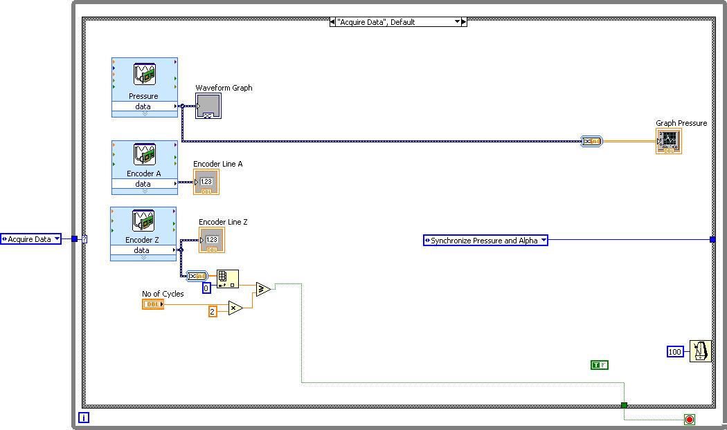

I cannot connect the output of "More Than" to Stop button (as figure below) as it will stop all the program.

If you want to go to the next state, under no circumstances do you want to wire a true value to the while loops termination terminal. A true value terminates the loop. There should be a false constant wired there. You want your case statement to either name the next state if acquisition is complete or the current state if the acquisition is not complete.

I've read your problem and what i can understad is that you want to do a state machine, with a state to adquire data and anothers states to do others things, in your program you must to replace the tunnels for shiftregisters in the while loop. Im sending you a exemplo of a state machine. Dont forget that all tunnels of the cases must be connected to the shifter register, if you do like that, the Stop Button will service just to finish the program whenever you want.
I hope that helps you
