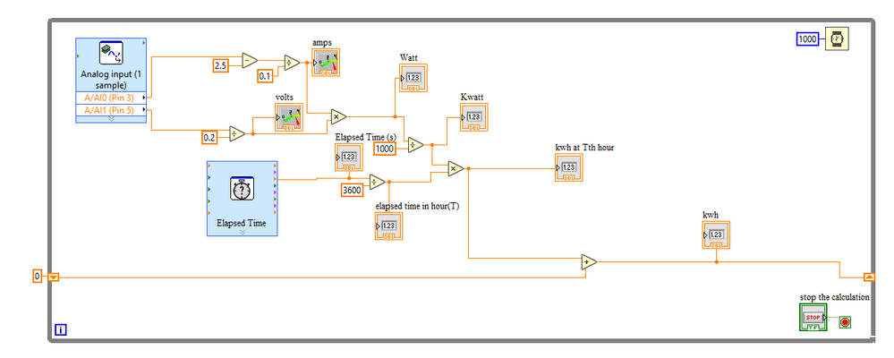

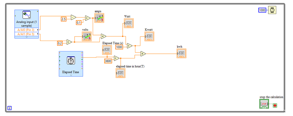

I'm sorry for not sharing the VI screen. here i attached the VI Screen. let me know is it correct? or need to be changed.
Thanks.

Wh meter for DC power
Well the basic formula you are using is about as good as you can do without an actual wattmeter with Ah integration. (Watts/time)
What exactly is your issue?
=== Engineer Ambiguously ===
Message 4 of 17
(7,373 Views)
I don't see where you are doing any accumulation of the watts.  You are just taking the current power and multiplying it the amount of time the program has been running.
So if you had 1 kW the first hour, 2 kW the 2nd hour, 3 kW the 3rd hour, you would have used 6 kWH.    But your VI takes the latest value of kW (3) and multiplies it by 3 hours making it look like 9 kWh.
You probably want a shift register to accumulate your watts as you read them.
Message 5 of 17
(7,372 Views)
Ravens Fan brings up a good point... I missed that.
Also doing it this way you have to make a certain amount of assumptions
The biggest being that you have to assume that your power is going to remain constant between measurement intervals.
Depending on your source, load, and sample rate this may or may not be constant. Having done a comparison when charging a battery between calculating Ah [(V*I)/t] and actual Wh integration there was as much as a %20 difference due to the "constant power" assumption at one second intervals.

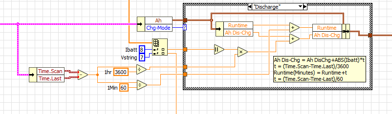

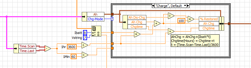

But for what it's worth, we decided that calculating was close enough for this one project and here is how I did it.
I just realized that this was calculating Amp Hours not Watt Hours...
Well it's basically the same thing (not really) but Wh = (V*I)/t instead of just I/t
Message 7 of 17
(7,357 Views)
