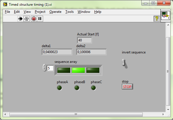

Win 7 64 bit with LV2011 64 bit

The results on my system are identical. 0.0400023 and 0.100006 deltas. My system is identical except that I have the 32 bit version of LabVIEW.

A small test shows my initial reaction seems right, although i scrapped that post since it sounded wrong ... 🙂
Get Date/Time in seconds is a slow and unreliable function, try it with Get Tickcount instead and you'll get the answer in ms directly.
With that change i get exactly 40 and 100ms resp.
