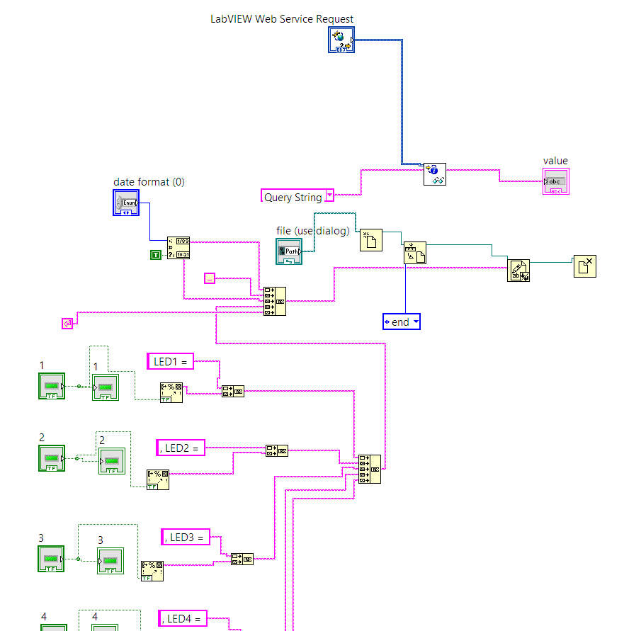

@mike, Ive putted the write logic inside the VI, and it doesnt execute whenever I fire a web request.

What errors are you getting?

No errors but when i look at the text file, it doesnt get written but the LEDs lights on and off

One reason you might not be getting any errors is that you aren't looking for errors. Connect up the error clusters and then display what you get.
Where are you getting the path that you are writing to?

@Mikeporter
The path im writing to is my desktop. im writing a text file

I believe the default for open file is 'open', not 'create'. If that is the case you are definitely getting an error, and you just are not checking for it or handling it.
I'd also recommend against the idea of logging directly from the web method. If you ever decide to add additional methods it would be easier to send log commands to a central vi. take a look at startup vis.
