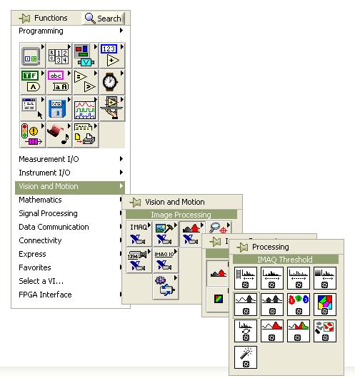

where to locate and how to use the filter thershould to binarized image
Good morning friends. I am using Labview with VDM and let me know where to locate and how to use the filter thershould. Also that parameters used to binarized image captured via webcam and display it in black and white.
Thank you very much.

Is the image that you are getting a RGB one? Use color plane extraction and then use a binary threshold to convert it into a binary image. You can also directly use a color threshold and convert a rgb (color) image to a binary image.
