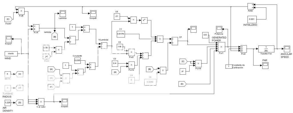

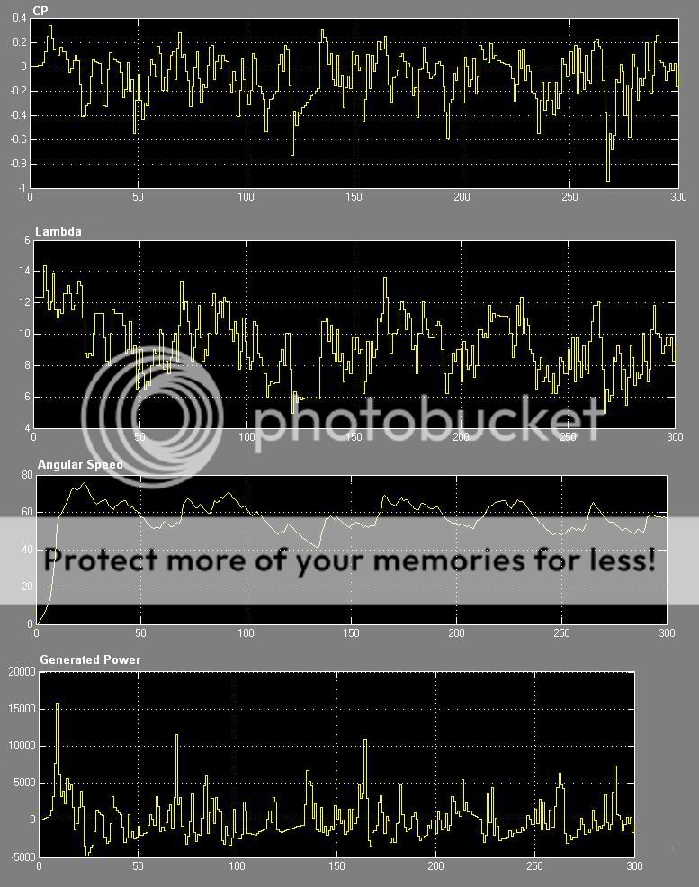

Here is my simulation in Matlab Simulink and its results:
Matlab Simulink scheme
Results

Can you post the formula you use to calculate the generated power and the angular speed?
The implementation in your turbina2.vi  seems unrealistic.  The angular velocity is the integral of the angular velocity from two iterations previously divided by the wind speed array cubed and other terms.  This would make the angular velocity infinite for zero wind speed.  The generated power term is dependent on the angular velocity divided by the wind speed.  Infinite power at zero speed!! Can I buy stock in your company?
