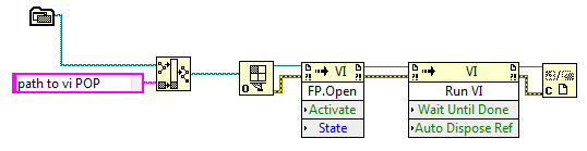

Hello. I wrote code in order to open a VI as a windows popup.
Running it in labview, it works fine. If I build the application (host side) and I run it in windows (win 7) it doesn't open any popup.
I'm sure that:
1) both the main and popup VIs are included inside the source files during the build steps.
2) the popup is not running behind the main window.
3) popup VI window appearance is "modal"
Here my code:
Does anyone know what to do?

I suspect you are building your path information incorrectly. I would start there to verify your path is correct in the built application. Also, just to clarify, you placed your dynamic VI in the Always Include section of your build spec, correct?

I wonder if the popup VI has its front panel removed during the build process.  See the "source file settings" for that VI.
Also, you should put some error handling in your code.  Eg pop up a dialog if an error occurs (Simple Error Handler.vi).  that way you can find the exect error that is ocurring.

josborn, I tryed to put error handing in my code, and I got some errors but I think thery are unuseful in my specific case. Here they are:
________
Built Application or Shared Library (DLL): Make sure all dynamically loaded VIs were properly included in the build specification for the application or shared library.
LabVIEW Real-Time: VIs built into executables cannot be accessed through VI Server calls. Use Source Distributions to dynamically call VIs on Real-Time targets.
___________
I got this error from the "Open VI reference" function. But...
About the first line, I'm sure all the involved VIs are included. I see the VI caller as "Startup VI" and the VI popup as "Always Included".
About the second line, I'm not testing it with a Real-Time target. I'm running this simple project just in a windows 7 environment. Anyway my VI server is running and setted in according with NI documentation.
