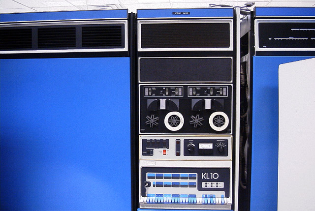

A KL-10
may have been one of the last machines designed by EE's without a lot of input from the software developers. It had the most robust instruction set I have ever used. It had machine code instructions that could solve hyperbolic functions in a sinlge instruction. It served as the hardware where VAXes where emulated in software prior to VMS becoming a reality. Vaxes where predicessors to Pentiums and VMS preceed Window NT (VMS ---> V+1 =W, M+1=N, S+1=T WNT).
The backplane of that machine looked like this
thos blue wires were the clock signals and required adjustments occationally to keep them all in sync.
Since memory was still tiny little ferite beads back then it was very expensive so the KL-10 hardware implemented variable lenght data fields so you could actually pack 12, 3-bit numbers into a single 36 bit memory location.
I know this does not answer the orignal question but it was too geeky for me to resist.
Ben
