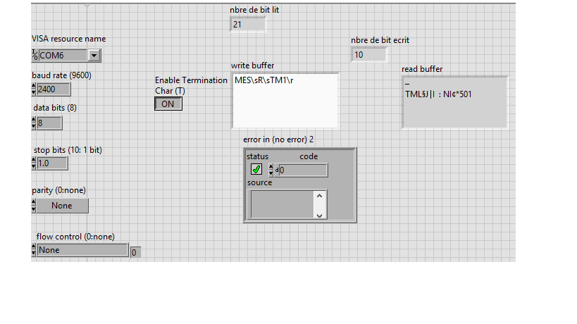

finally i'm gettin a message it was a problem with the rs232 cable, but i'can't understand the message:ar.png

You have now set it for 8 data bits and the manual says to use 7.

it's 7 data bit+ 1space
now it works  🙂  but there is an error message that's shown every time and keeps me disabled to run the VI continously. i attached two images for the front panel and the error message. thanks

Change your termination character to a carriage return.
