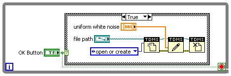

I have a signal and should the amplitude exceed a threshold (in my case for eg 5), then a pop-up is initiated and asks the user if they would like to save the event as a new array/database in a file on cRIO memory (later to be flash drive memory).
If they save it, it will take the value of the amplitude when the signal exceeded the threshold, feed this value into a uniform wave vi, and capture the 128 samples of the output wave from the uniform wave vi in the newly named file.
Each time I run my code it shall check the folder/location I am saving files and open all files inside to perform a calculation on the data in the files.
At the moment I am having trouble getting my code to simply write a tdms file as a message displays, stating that I do not have the correct permissions and I am just wondering if I am saving it correctly? I have attached the simple writing to tdms vi. Am I going about this ok or is there an easier way for me to capture a window of data from a signal and save its amplitudes to be referenced later?

Hi gerdw,
I have attached my code perhaps you can tell me why it doesn't seem to write? i have also contacted NI UK tech support but perhaps you might be able to see where I am going wrong as it will be a while before they can respond.

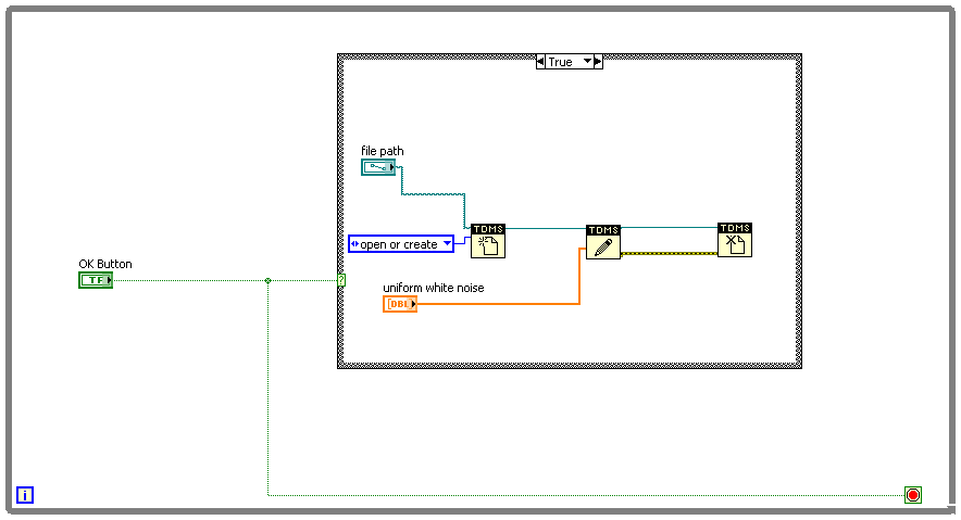

Hi Kelly,
before CleanUp:
and after CleanUp:
What's messier here? (Keep in mind I look at this on a 1280×800px laptop screen: while your VI fills nearly the full screen mine is just 1/10 of the screen…)
I also think it's some kind of respect for those who are willing to help when you clean up your VIs before attaching them!
I have been successful in reading and writing tdms previously in this exact structure but i am wondering why it is not allowing me permission now.
When this piece of code did work before and it doesn't now, then you have changed something in between. What's changed?
