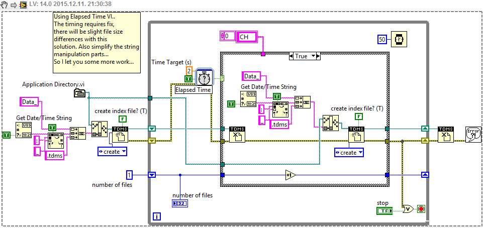

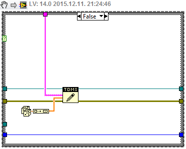

Here is a snippet to play with it:
(4,192 Views)
Dear Blokk, Thanks very much for your help. I got your idea and have replicated your program. You can be a very good teacher.
