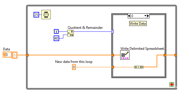

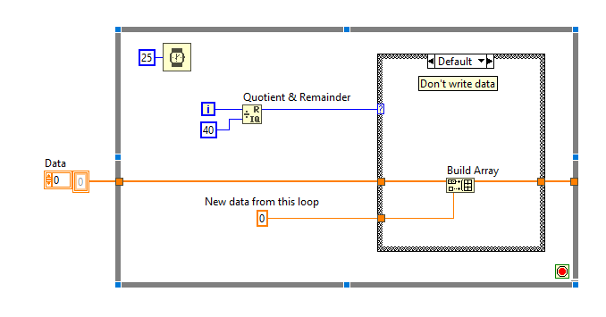

You can capture all the data without writing all of the data every time you receive it. I would recommend looking into the producer consumer architecture so that writing the data does not effect your acquisition. However, to answer your original question of how to write the data once per second, you can do it in the following way. These two pictures are the same VI, just with different cases shown.
