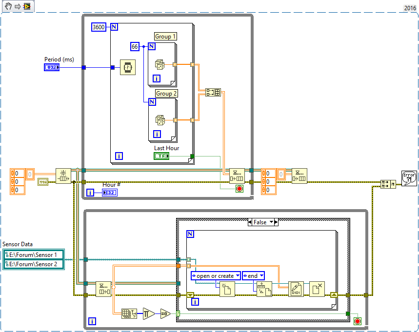

Well, I cheated and wrote Binary Files, and simulated data from 66 sensors sped up by a factor of 1000 (since I took data once a millisecond instead of once a second, but who wants to wait an hour?).
This is a Producer/Consumer Design.  The top loop acquires 3600 samples once a "tick" from two sets of 66 sensors, then combines the two 2-D Sensor Arrays into an All Sensor 3-D array and puts it on a Queue.  The bottom loop takes data off the Queue and if the array isn't empty (see next paragraph), splits it into the two Sensors and writes each Sensor into a separate file, concatenating the data by "adding to the end" of the files.  If you start with existing files, it will just keep appending.  The files stay closed when the Writes are not taking place.
The Stop Button has been changed to "Switch when Pressed" and placed within the hourly collection loop to ensure you get a full "Last Hour" -- you can change this behavior if you want.
When the Producer Loop ends, it places a "Sentinel", an empty array, on the Queue, but otherwise leaves the Queue alone.  When the Consumer sees this, it knows the Producer is done, so it can safely Release the Queue and stop itself.
This is probably not exactly what you want, but should have elements that work for you.  The Producer/Consumer Design means that the Data Acquisition and Data Storage work independently of (and simultaneously with) each other, so no Data are lost between Acquisition and Writing.  If you also want to plot the data, you could do that by putting your Queue inside the "3600" loop and exporting every data point to the Consumer.  If you want to (a) Plot Every point (once/second) and (b) Save Every 3600 points (once/hour), you just have two P/C loops, Acquisition -> Plot -> Write File.
I encourage you to test code by writing Simulation Routines such as this.  They can be small (see below) and used to test ideas and find bugs (I initially had my "Build Array" function in the top loop in the wrong place, and got very strange File Sizes ...).
Save Hourly Sensors.png Bob Schor
