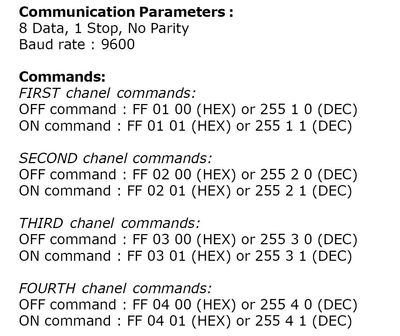

The manufacturer didn't make it easy to find the command protocol for this board... It's zipped up in this archive: http://s3.amazonaws.com/s3.image.smart/download/101-70-118/20-018-910.rar in the file "usb command.jpg" (that's right, a JPEG of text).
You'll need to send these commands using the FTDI D2XX driver, or you could simplify things a lot by enabling the virtual COM port (VCP) in the FTDI driver, and then using VISA to send the commands.

It actually seems to be even easier than what people are suggesting with DLLs and C#.
This should show up as a serial port on your computer. I attached a file which is apparently the ON and OFF command you send to the serial port for each relay.
So find the appropriate COM port in labview, open it with the communication parameters that are listed in the JPG, then write out those HEX strings using the serial write commands.
Hopefully that works as it is the easiest path forward.

ok great I used the VISA commands you sent me and it works nicely. Thanks again.
