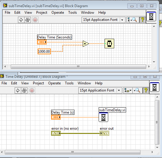

I seem to recall hearing mixed reviews about Express VIs in general.
That would be the very rare exception to the rule.  Time Delay Express.vi is actually useful and has very limited overhead.
When you "pop-the hood" and actually look inside the express vis (right-click>> Open Front Panel...say yes at the prompt) You find this simple implementation:
That is a "Good" Express vi! the "Expressness" is only there to script the configuration of the time pop-up and is helpful in populating the help for the instance.  No run-time penalty!
