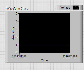

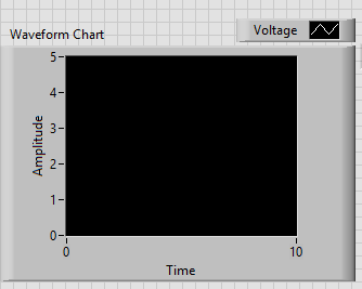

i wanna see this
but i keep seeing this
Hatef.fouladi, i tried to do as your vi, it almost worked, but it keeps flashing between the value i want and the autoscale value.
im working with daq and sensors, so you probably wouldnt be able to run the code.
