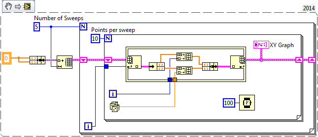

Sure, you have just have to be careful about how you send the data to the graph. Make the data an array of a cluster of two 1D numeric arrays. Each iteration you will "build array" with the old data to keep all your traces intact. Then once you've completed your entire sweep, you will store that data in a shift register to be used for your next sweep.
