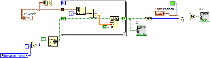

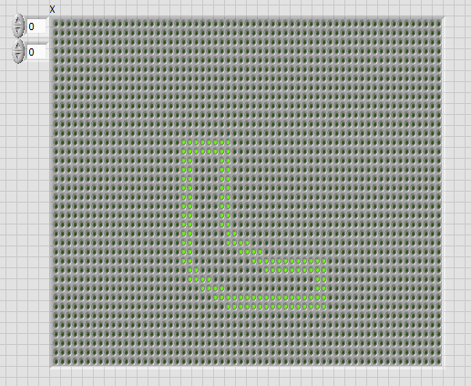

Here's my attempt.
Cheers

but now iam stucked with the next problem .. i want to floodfill (set TRUE) everything within the shape. i've attached the code for the floodfill.
it works well with simple figures like a rectangle ... but not with bended figures. any idea why?
edit: i can't attach the vi ... it says "The attachment's FloodFill.vi content type (application/octet_stream) does not match its file extension and has been removed." 😞
1. You really should learn about Autoindexing Tunnels.  They will simplify your loop since you will not need the Array Size or the Index Array.
2. The attaching the VI is a common issue on these forums.  Put your code in a zip file and attach that as an alternative.

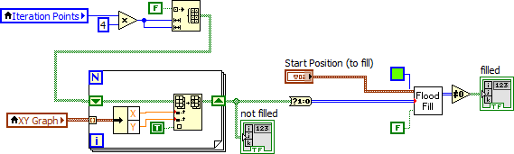

hi altenbach,
unfortunately iam still stucked ...
the x/y values of the figure have 5 decimal places but using your method (via replace array subset) it only takes the value before the decimal point.
so no matter how precise or how many xy pairs describes the figure in the xy graph the figure in the 2D boolean array stays the same.
got any idea on how to solve this problem?
the actual reason why i convert the xy graph to a 2D boolean array is to fill the figure with equidistant points.
i've found no method to do this in a xy graph.
here's the actual code + floodfill.zip:
many many thanks in advance!! you guys are so much help 🙂

You simply need to map the values into a sufficiently large range of integers. Then set x0 and dx of the graph accordingly.
