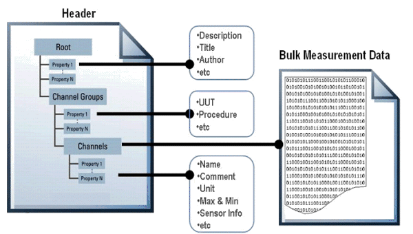

The NI Technical Data Management Streaming (TDMS) file format is the fastest and most flexible way to store measurement data to disk. Developers have long used the LabWindows/CVI TDMS API to attach timing information and custom-defined attributes to measurement data as it streams to disk. Storing data in TDMS files eliminates the need to design and maintain custom data file formats while creating well documented data sets that can be easily searched and ported to any platform.
» Read an Introduction to the LabWindows/CVI TDM Streaming Library
Fig 4. Write measurement data to a TDMS file using the built-in libraries to better organize data sets by group and add descriptive meta-data about each data set.

| Note When you write data to a .tdms file, the data includes meta data and raw data. Refer to TDMS File Format Internal Structure for more information about meta data and raw data in a .tdms file. |

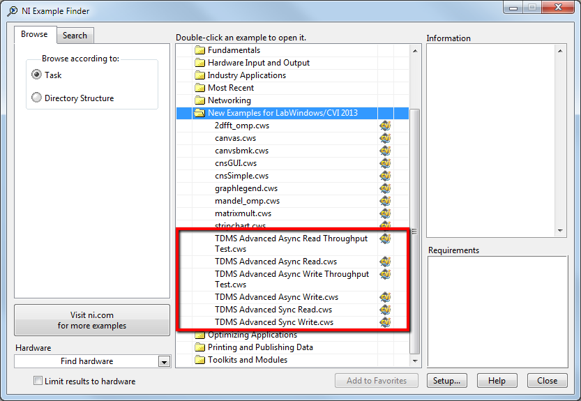

The scenario you proposed is supported and I have attached an example to the document above. In the code we have a thread that is writing some data to a tdms file using TDMS_AdvancedSyncWrite. In another thread we read a random chunk from previously written tdms data and do some basic verification to validate that read data. Be careful to change read position using TDMS_SetNextReadPosition before actually reading desired data.
