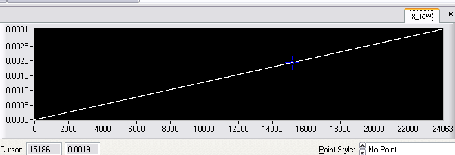

There are two options: use graphical array view, which works for larger arrays, too.

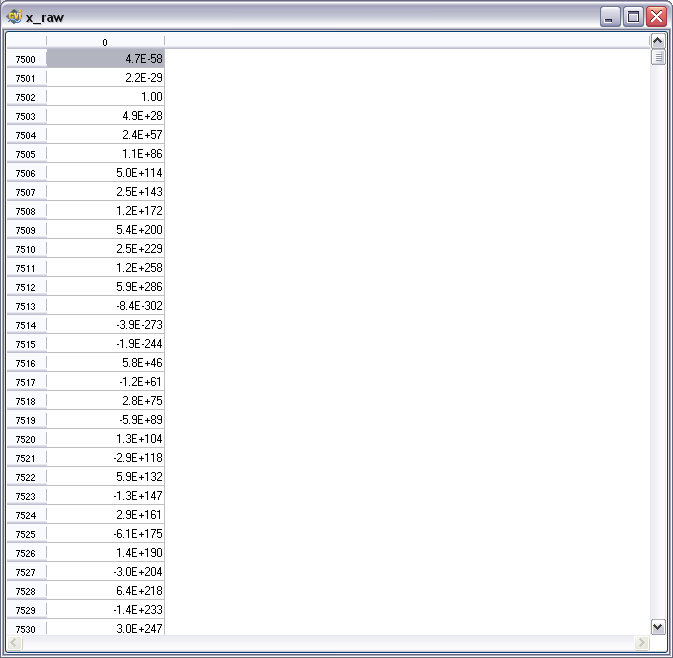

In my case, x_raw consists of 24064 data points, but only 10000 can be loaded into the Array Display table simultaneously - which at first glance does not seem to be a restriction as one is not able to look at that many numbers simultaneously.
But it still is a restriction as there is no possibility to change this selection... Smiley Sad So if one is interested in say data points 500, 11000, 22000 at present it seems impossible to do that...

Hello Wolfgang,
For test I have made in simple array of double like this one :
double tab[30000];
for(int i=0; i<30000; i++) tab[i]=i;
I 've tried to change the slice in the array view, but the result seems to be very curious. You could see that in the attached jpg.
Best regards.
Message 3 of 10
(6,939 Views)
You seem to be right, I tried with my code and here, too, the table shows wrong results, seems like you have found a bug 😉
