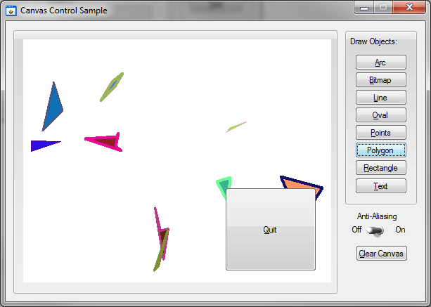

I tried to reproduce this by modifying the samples\userint\canvas.cws example program by placing one of the buttons on top of the canvas:
... but I wasn't able to reproduce the problem. Clearing the canvas cleared everything. So there must be some other subtle difference in your program. Would you be able to attach here a reduced version of your program that reproduces the problem?
Luis
