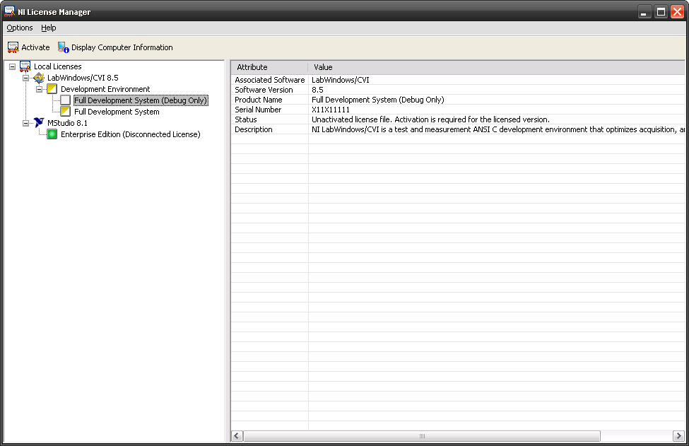

I am still seeing "Eval Version" popup on a system that I think is fully activated with a good license.
This particular system did in fact have an eval version of CVI 8.5 on it, but since then I've reinstalled CVI 8.5 from CD and added a disconnected Measurement Studio 8.1 Enterprise Edition license from our volume server to it.
It seems as if the eval mode version has "stuck" somehow, despite our adding a MS 8.1 EE license, which should have activated the CVI 8.5 FDS.
In other words, it looks as if an eval version of 8.5 installed using a binary downloaded from the NI site will not "come clean" with a license from a volume license server rather than an activation code from an NI server, despite re-installing from CD-ROM?
Maybe the CD rom install didn't over-write the eval version of the RTE?  I should think that the eval popup is coming from the RTE.
This particular system does not have LAN access to the volume license server or the Internet.
I'va attached a file with screen shots of the license manager.  It looks like there's several licenses floating around on this system, including an eval license, I should be able to remove several of them I would think?

To use a debug-only version of CVI, you would have to have a CVI debug serial number, and activate the Full Development System (Debug Only) option in license mananger.  Because these nodes were still white in the screenshots, it doesn't seem that you had done this yet.  Also, you are correct in assuming that with the Measurement Studio 8.1 disconnected license you should be able to check out CVI 8.5.  I am also curious as to why CVI is not being checked out on your machine, because I was able to replicate you situation as seen in the screenshot below, and could successfully check out CVI 8.5.
Could you please post a screenshot of the evaluation window that shows when you launch CVI, as shown in the below screenshot?  Also note the portion I have outlined in red, as this is the important information.
Finally, you are correct that you should be able to remove many of those licenses in your licenses folder.  Because the Measurement Studio Enterprise license enables you to use CVI, you do not necessarily need all three of the CVI_FDS licenses, although, as I said before, they caused me no trouble when they were in there.  This would certainly be a good step to try however.  Perhaps the best thing to do would be not to delete the files, but to create a folder in this directory named 'old licenses' or something similar, and place these CVI licenses in there, to see if this makes any difference.  Also, the TmpEthernet licenses that you see are a feature implemented with VLM, so that if your computer becomes disconnected from the network for any reason, you will be able to continue to use your software for up to 14 days.  Thus, if you are only going to be activating locally, and not checking out licenses from a license server these licenses are not necessary either.  Please let me know if you have any further questions.

I certainly don't mean to argue with you, but based on the last screenshot you included, CVI had not been activated under debug mode.  If it had been activated under debug mode, the node next to "Full Development System (Debug Only)" would show up green, as shown below:
The first thing that I would try if I were in your situation is to rebuild the application in question.  Because you do not see the evaluation window I mentioned in my first message, you are successfully checking out the license from the Measurement Studio disconnected license.  However, if the application in question had last been built under evaluation mode, it is still crippled to the ten minute limit the evaluation license imposes.  However, if you were to rebuild the application now that you are successfully launching CVI, the evaluation message should go away.
Finally, just to answer a couple of the other questions you posed.  The nodes in NILM will only turn green when they have been successfully activated through the product activation  wizard, or by importing a disconnected license from VLM.  I certainly think that ripping out the RTE dll's would be a little bit of overkill for this situation, and following some less drastic troubleshooting steps should no doubt be able to resolve this issue.   If rebuilding the dll does not solve this issue, could you please post a screenshot of the timeout popup that you are receiving?  Thanks!
