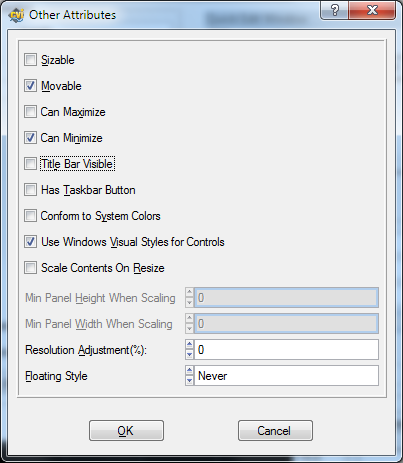

I think a good start would be to set Titlebar Visible to false. This will hide the borders and title bar (including buttons).Then you could resize the application to the client's resolution or maximize the panel (using SetPanelAttribute([panel handle], ATTR_WINDOW_ZOOM , VAL_MAXIMIZE);), whichever works best for you.

Hi Nelu F,
I just tried your suggestion (using CVI2013f1): setting Title Bar Visible to false does not work... it remains visible

Hello silentbilos,
I attached a sample that is shipped with LabWindows/CVI that I modified as I suggested. Does it work for you?

Hey thanks for helping.. the sample is not working but i successfully run it on full screen
