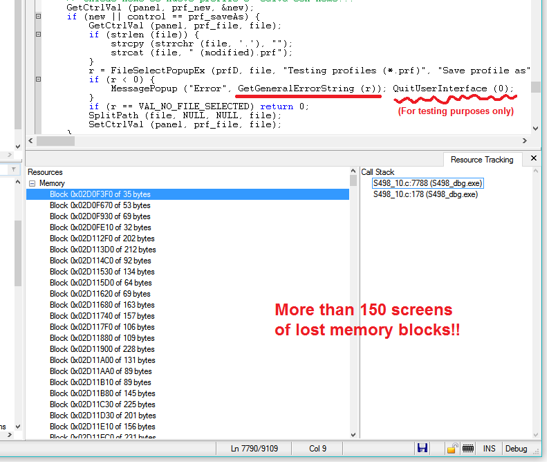

As a side note, when called for error -180, GetGeneralErrorString produces a long list of lost memory blocks (the Resource tracking lists 3000+ of them Smiley Surprised , each with the line of the function and the line of RunUserInterface in the call stack).

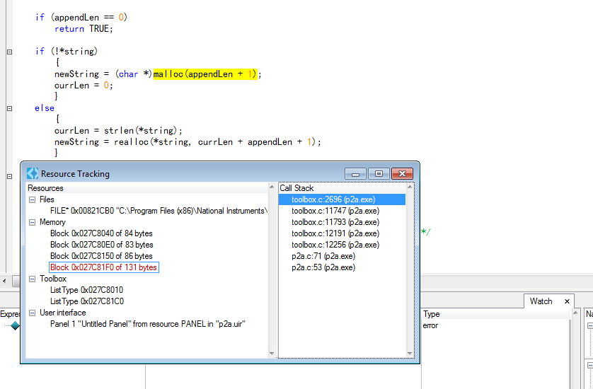

When you call GetGeneralErrorString with -180(or an invalid error code) the code takes a different path that allocates some memory once and stays allocated while the program runs. You can see exactly where the memory is allocated if you add toolbox.c in your project rather than toolbox.fp(see image below).
So it is a one-time memory allocation that stays allocated while the program runs.

What I don't understant is why you get 4 lost blocks while I get 3000+ !!
As you pointed out, all that memory is allocated in AppendString which is repeatedly called by CVINiErrParseFile () function; it seems to me a correct coding should be made to free all those blocks when no longer needed: even considering a few dozen bytes per block, the total memory lost on one single call of GetGeneralErrorString is important if multiplied by 3000+ ocurrences!

In my screenshot I was suspended at a breakpoint but after everything executes there are about 256 blocks.
The reason for allocated blocks are not freed at the end of GetGeneralErrorString is that you might call GetGeneralErrorString again and need to allocate all again in this case. The occupied memory is not very high, it's about the size of the files in C:\Program Files (x86)\National Instruments\Shared\Errors\<language>(~40k)
