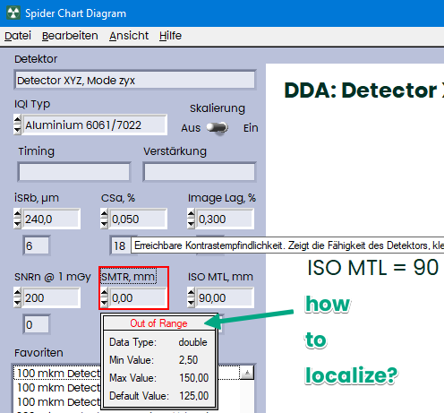

My application has been translated into German using LWCVI Language Resource Files, but I don't know how to change the following text:
It’s a nice feature of CVI, but I haven’t been able to find where this string is stored (maybe I’m just overlooking it). Could you help me out, please?

These and other error messages are located inside the message file of the CVI Run-Time Engine, which you can translate according to your whishes.
This activity is described in the help of CVI as can be seen here. I never attempted to do this, but you may want to try since it's the only way to localize built-in messages.

Ah, of course msgrte.txt, thank you!
Well, it works in general, I found this popup text is in this file. The only question is — how to reload this file "on the fly" when I switching between two languages without restarting whole application? I using LocalizePanelUtf8() to switch between languages, and it works, but I don't see API to take other msgrte.txt.
(486 Views)
Yes, it is loaded from C:\Windows\System32\cvirte\bin\msgrte.txt. It seems that there is no way to reload this "on the fly," but I was able to "switch" it by patching the strings in memory:
