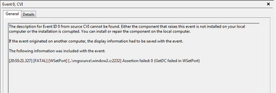

In the event log, I've got the following event :
The description for Event ID 0 from source CVI cannot be found. Either the component that raises this event is not installed on your local computer or the installation is corrupted. You can install or repair the component on the local computer.
If the event originated on another computer, the display information had to be saved with the event.
The following information was included with the event:
[14:23:58.940] [FATAL] [IValidateImage] [..\mgsource\image.c:9033] Assertion failed: FALSE (Bad image in IValidateImage)
The message resource is present but the message was not found in the message table
or
[11:53:41.482] [FATAL] [WSetPort] [..\mgsource\window2.c:2245] Assertion failed: 0 (GetDC failed in WSetPort)
or
The program cvi.exe version 15.0.1.240 stopped interacting with Windows and was closed. To see if more information about the problem is available, check the problem history in the Security and Maintenance control panel.
Process ID: 3fa4
Start Time: 01d81c0469f8552f
Termination Time: 4294967295
Application Path: C:\Program Files (x86)\National Instruments\CVI2015\cvi.exe
Report Id: 66d1840f-aa86-4b1f-b826-0ba7e57702e2
Faulting package full name:
Faulting package-relative application ID:
Hang type: Top level window is idle
I've tried to uninstall,everything and then re-install all from the begining but Labwindows is still crashing.

Hello all,
I have same error using CVI2010 SP1 with NI Divece drivers 2011 on Win 7.
Sometimes at an undefined time something crashes the application made in cvi. I reinstalled CVI but without success.
Does anyone have an idea how I could solve this problem?
Thank you very much !
