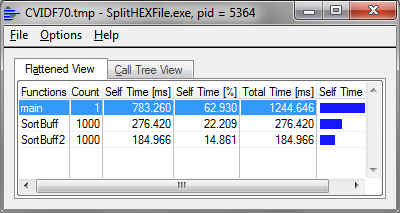

Hmmm... that's curious.  15 minutes seems like a *very* long time for your code to be running.  I copied your function exactly and ran it against a .HEX file of 30k bytes, and I was able to execute your function 1000 times in 275ms:
I'm really not sure why you'd be seeing such long execution times.  My only guess is in your call to fopen.  You pass "rt" as the mode, but this is not a valid mode for fopen.  You want to pass "rb" - this way you can be sure that the value you get back from ftell is representative of the number of bytes in the file.  If I were you, I'd validate that you are reading what you expect from the file.
I took a quick crack at using strtok to split up the hex file, and found that it was a little less than twice as fast as the code you posted - you could also give something like the following a try:

I was honestly surprised to see my code execute more quickly than yours.  I think the reason for this is my use of the CVI release compiler.  The strtok and strlen functions I used were compiled with optimizations, whereas the CVI compiler is not an optimizing compiler.  This means that the strtok method may be faster if you are using the CVI release compiler, but if you're able to use a 3rd party optimizing compiler for your release compiler, you should see better performance with the code you wrote.  I tried both the clang 1.0 optimizing compiler and the MSVC 10.0 optimizing compiler, and in both cases your code ran about 25% faster than mine.
