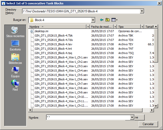

When resizing the "select folder" dialogue that pops out during MakeDir(), the "Done" button does not re-position and so may turn invisible.
This is on Win7 running Labwindows/CSin título.pngVI

- Did you mean the function 'DirSelectPopup'? MakeDir does not show a popup panel.
- I'm using this function, too, but I have not seen this effect, and also not found a related entry in the Known Issues list..
- CVI 9 does not officially support Windows 7, see here Maybe you can try your code with a newer version of the run time engine, e.g. this one?

Your comments are 100% right
The problem is solved after updating the RTE to the version you posted.
