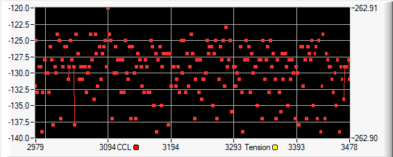

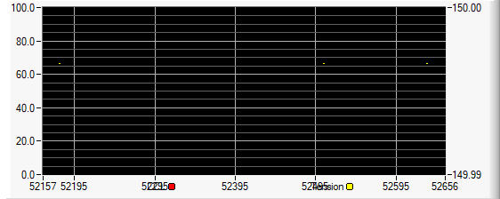

I've made a strip chart to show data from a tension device.
However it doesn't show a continuous solid line, only dots here and there. In the screenshot below there is 3 yellow dots, how do I make this into a continous line instead?
Line style is set as solid under traces and scroll mode is continuous
Appreciate any help and suggestions!

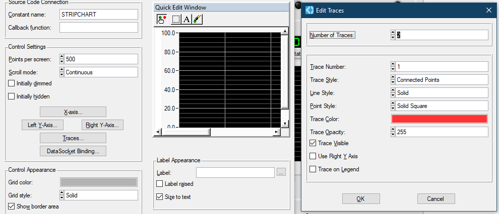

It is possible to tailor a strip chart to obtain what you show but it requires a bit of effort either in the UI editor or in code.
You should revise the strip chart control and specifically traces settings: I seem to understand that your control holds two traces so you must revise the attributes for all of them in order to be sure of how the control is set. After that, revise the code to be sure that no SetTraceAttribute () commands exist or double check them if you positively added them with specific purposes.

I've searched the code and there isn't any SetTraceAttribute anywhere.
I had "Thin line" as trace style, played around a little and choose connected points and enabled solid square points just to see if that would help.
It does show all the points, but only sometimes the actual line between points:
Are there any other settings that I could look into?

I don't know how to conclude from this, but suddenly it started working. From drawing only dots and some lines here and there, it started to display a solid line. I suspect it is due to a more stable signal, but i would assume it to should draw a solid line between the dots no mather how often they appeared...
Thanks Roberto for helping troubleshoot!
