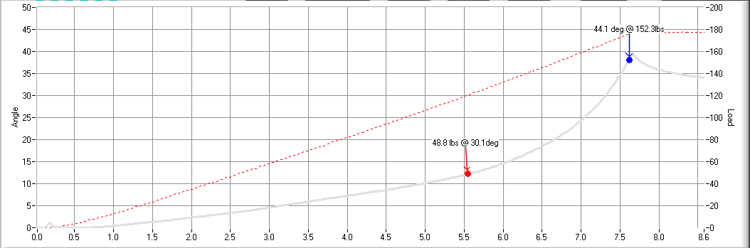

Trying to print a simple graph, but the fule is unreadable. The function returns success when SetPrintAttribute() is set to either option. I've attached the bitmap which should be roughly as below (yes I know it needs work!)
Graph WIP

Thanks but that didn't make any difference. Opening the file in a hex viewer shows that the start is a load of random print driver settings. I'd say it's looking like a bug at the moment.

I don't completely understand your situation. Which file is this, exactly? Is this a .bmp file that you are trying to display on the graph? And which SetPrintAttribute options are you referring to?

The file I attached is a bitmap file produced by PrintCtrl but renamed as this board won't accept .bmp extensions. The SetPrintAttribute options I referred either draws the control to an intermediate bitmap or not. The whole thing is a cheap'n'dirty way to print a graph onto a report, since NIReports doesn't offer this feature and I haven't got the time to spare to do it properly in Word and Excel.

As far as I can understand you want to obtain an image out of your graph and include it in a report with NIReport_AppendImageFile.
If this is your situation you could:
1. Obtain a bitmap of your graph control with GetCtrlDisplayBitmap
2. Save the bitmap to a file with SaveBitmapToBMPFile or SavebitmapToJPEGFile
3. Discard the bitmap
4. Append the image tot he report
The file you obtain from PrintCtrl is a print file (i.e. a file intended to be sent to the printer, that includes control codes for the printer). The intermediate bitmap optionally used internallyby PrintCtrl is not available for direct use.

Thanks, that clears things up nicely. I have been using GetScaledCtrlDisplayBitmap, but am having to save at 2/3 scale and the image is blurry. I think we're becoming victims of ever increasing screen resolution, since the size of paper never changes.

You could duplicate the graph on a hidden panel and rescale it before getting the image of the control: with auto divisions on at least axes and grid should maintain a good aspect even on small sizes.
