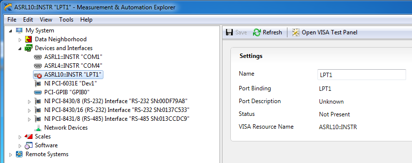

O.K., after disconnecting all serial devices, just keeping the NI serial boards installed and still receiving the same error I looked a bit more carefully (I could have been more careful earlier, of course...) and realized that the problematic port is assigned to LPT 1.
Well, my new computer does not have LPT 1. MAX, for example, knows this and shows a red x.
So, this explains everything - does it?
After viFindRsrc ( resource_manager_handle, "ASRL[0-9]*::?*INSTR", &find_handle, &return_count, instrument_descriptor );
my software checks the port type (COM (RS232/RS485) or LPT) for each port and this worked in the past because LPT 1 was present.

Here is the respective screen shot of MAX...
Message 8 of 10
(6,493 Views)
One last note: Windows device manager does not list a LPT, so I consider my observation a bug in VISA (the latest version).
My software and MAX are showing the same result, they find a resource but cannot open it. Smiley Frustrated
