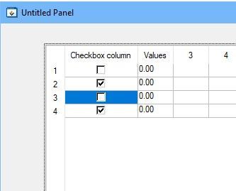

I just finished making a cool little library.  The lib allows me to configure table control column cells to behave like a checkbox control, which is currently not supported natively. My lib does a ChainCtrlCallback in order to handle the checkbox image swapping (from checked to unchecked).  Give it a column from your table, and the lib makes the necessary cell changes to both new and existing cells.  Call the lib Set/Get functions to toggle the image.  It all works nicely in a standalone fashion in a simple, small test project.
But now I'm attaching this lib to a bigger project, and now I am seeing General Protection Faults immediately upon RunUserInterface in the application.  So it's not debuggable.
