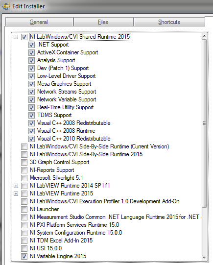

What did you select in the Edit Installer dialogue?

Hmm, this is strange.  It shows that I have all the runtime options installed.
