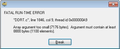

They are global variables.  The error is completely random.  It can work for 5 minutes, or last night it ran all the way through with no issues.  It is always on the second task.  The error box does tell me how many bytes it is expecting and how many it gets.  Why would it work most of the time and then fail to return the proper number of bytes?  The chassis is an older 9178 cDAQ chassis (white, not grey).

Here is the error it throws.  The number of bytes received is random.
