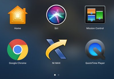

I'm using a macBook Pro with Mac OS 10.15.1, I installed NI Max Version 17.0.0 several month back in which it did crash at first, now it's working without crashing. I just cannot configure any instruments such as a tektronix scope. Attached is a screen shot of NI Max Hardware config.
