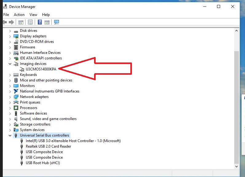

Hi, I emailed vendor about it, but they didnt help at all.
I don't even see ImaQdx device in MAX when I click Devices and Interface. Instead, I can just see Toupcam "cam0", and if I click that one, it just gives me error sign and crashes MAX.
I also installed Directshow driver provided from camera company.
Anyway, Am I supposed to see USB camera under Imaging devices in device manager if I want to use it in labview or it should be under other place.
Please see the attachment
and also in second screenshot, do I have to do something about niu3v.dll file?
Could you please help me?
Message 6 of 9
(6,414 Views)
The way you have the driver setup is correct. The vendor driver simply seems to be buggy with IMAQdx, and unfortunately it would likely need help from the vendor to fix.
