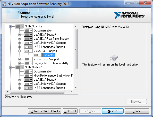

If you have vision acquisition software there should bean option to include Visual C examples during the installation.  You can check/repair the installation to include these examples.  In MAX expand "Devices and Interfaces" then right-click on software and select  "Change/Remove Software"  this will bring up the Windows Modify/Repair/Remove wizard for National Instruments software.  Select NI-IMAQ then click modify, you will need the VAS disk.  Then select to include examples.
After the examples are installed you can go to Start >> All Programs >> National Instruments >> Vision >> Text-Based Examples.  I would open the read and and define the image type as U16.  There will be unused bits but the IMAQ display will scale it to 8-bit resolution.
