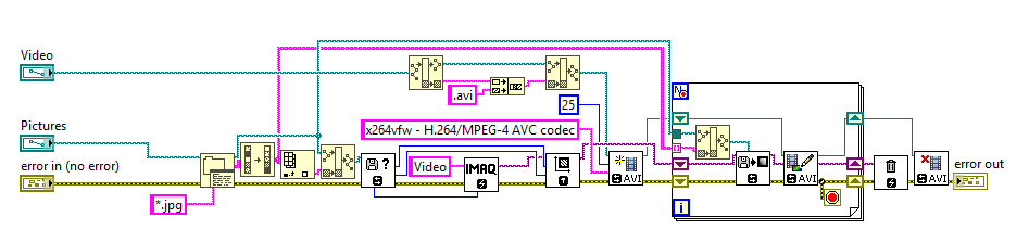

Picking up this thread again:
Since AVI2 it is possible to use the the x264vfw codec. I just ran into some problems to get it done as "AVI2 Get Codec Names" (http://zone.ni.com/reference/en-XX/help/370281AE-01/imaqvision/imaq_avi2_get_codec_names/) is not listing all my installed codecs.
What you need to do is:
1. use the example VI "AVI Compressor Comparison" as mentioned here https://knowledge.ni.com/KnowledgeArticleDetails?id=kA00Z0000019M0ySAE&l=de-DE. You will get all your installed codecs listed and probably an error, at least in my case, as the VI can not compare the codecs properly.
2. Copy the codec string and place it as string constant for "AVI2 Create" (see: https://knowledge.ni.com/KnowledgeArticleDetails?id=kA00Z0000019M0ySAE&l=de-DE)
3. Now it is important to know which picture/video formates (width and heigth) your prefered codec can compress! E.g. the "x264vfw - H.264/MPEG-4 AVC codec" is only able to compress pictures with width and heigth as a multiple of 2.
I got a series of pictures (1000 up to 100000 pictures) and create a compressed video with these. This is the code i am using and its working out perfectly for me.
The difference to your task is just that you need to implement the compression into your realtime recording, but i think it should work out quite fine.
