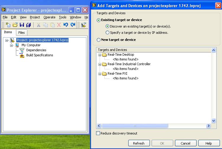

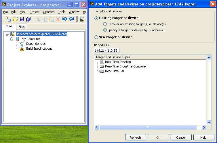

I have a similar problem to grekop, I have Labview 9.0 installed, I can grab pictures through MAX and Vision Assistant and IMAQ Vision Builder 6.1. I have a NI 1742 connected through ethernet, but I can't add the Smart Camera as a target or device, I send you an image of the problem:
Here I inserted the IP address of the camera but the OK button is disabled.
Do I need another software? Here's the software I have installed:
Thanks for your help.

bebin,

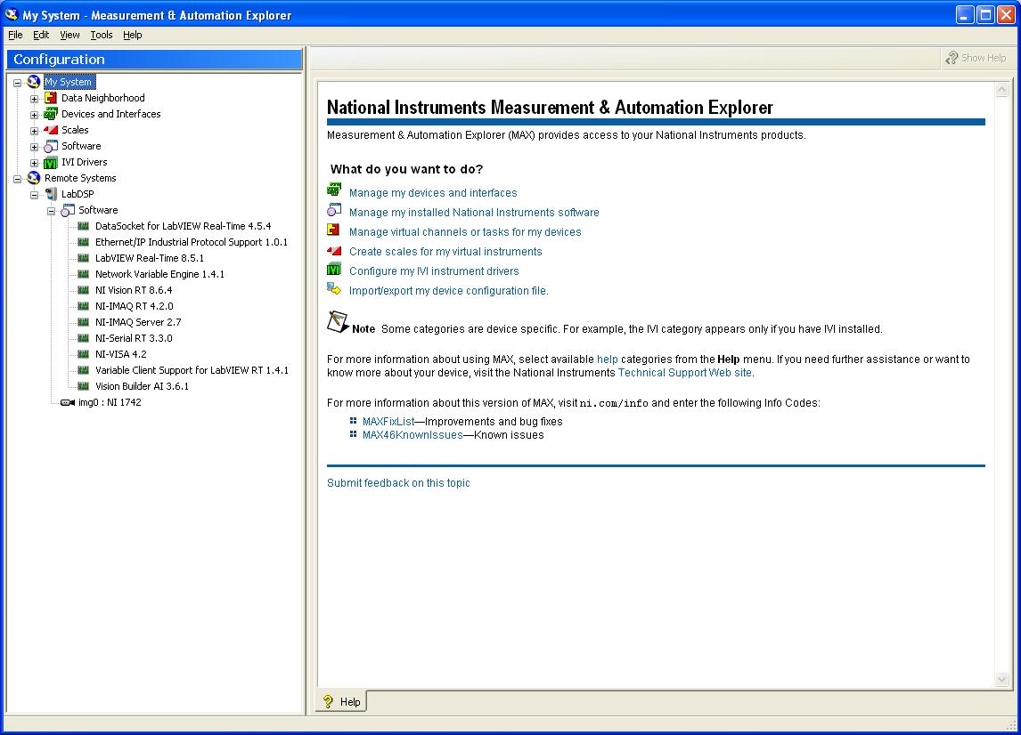

This is still a problem relating to RealTime or versioning.  It looks like you have LV 2009 (but I can't tell if you have LV RealTime 2009 on your PC because LV 2009 section isn't expanded).  It looks like you have LV RT 8.5.1 on you camera.  Double check you have LV RT 2009 installed on the PC.  Then right-click on the smart camera in Measurement & Automation Explorer (MAX) and select Add/Remove software.  You can then load LV RT 2009 on the smart camera.  You want the same version of RT on the camera and PC.

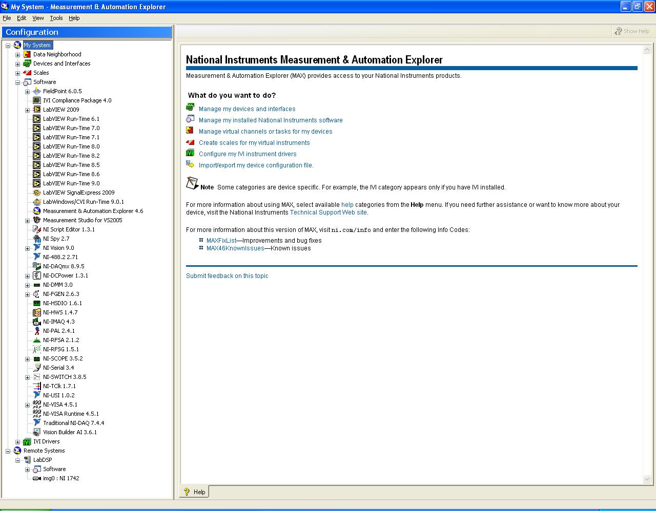

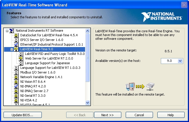

Hi Kristen, thanks for your answer. Of course, I have LabVIEW 2009 and LabVIEW Real-Time module 2009 installed on the PC.

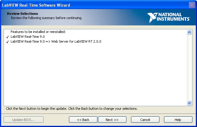

I can see that Smart Camera have installed LabVIEW Real-Time 8.5.1, but when I try to update to LV RT 9.0 (2009):
and I see the review selections:

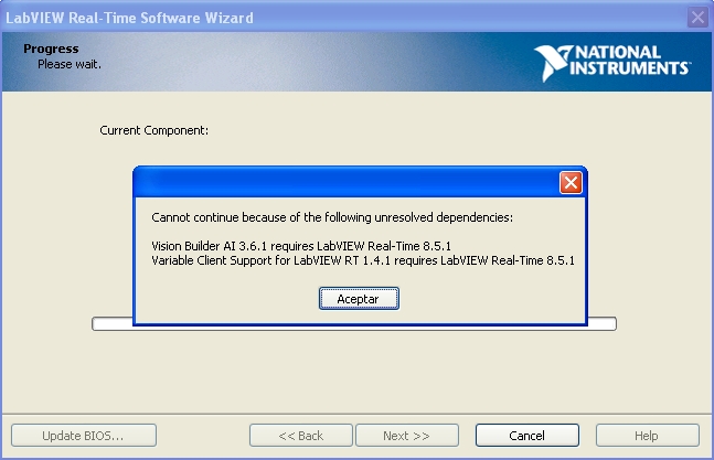

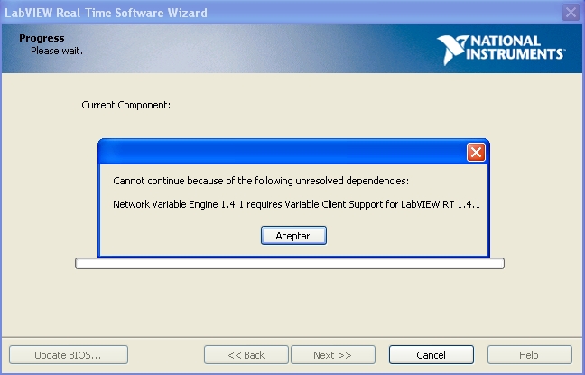

 Then I click Next and the next error message appears:

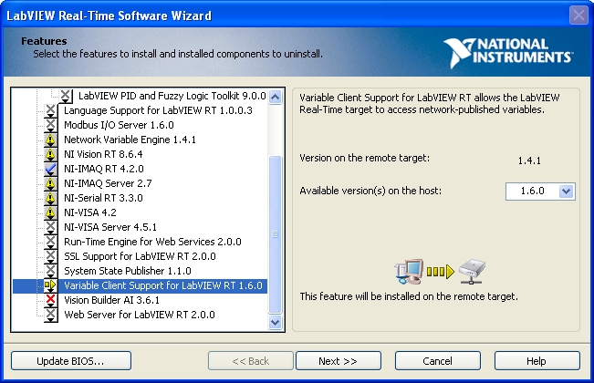

 I understand about dependencies (like Windows services), so, I unistalled succesfully Vision Builder AI 3.6.1, but the problem persist with Variable Client Support for LabVIEW 1.4.1, then I tried to update it to Variable Client Support 1.6.0 which is available on the host
but another error message appeared:

Hi again, I forgot to tell you, when I try to update or reinstall Network Variable Engine 1.4.1 (the one which depends of Variable Client Support) to version 1.6.0 which is available, appears the error message:
Cannot continue because of the following unresolved dependencies:
NVE Core 1.6.0 requires Variable Client Support for LabVIEW RT 1.6.0
This is something strange for me, because first, there is no any NVE Core 1.6.0 on the list of features to install or installed, and second, NVE Core 1.6.0 requires Variable Client Support for LabVIEW RT 1.6.0, and that's the version which I'm trying to update.

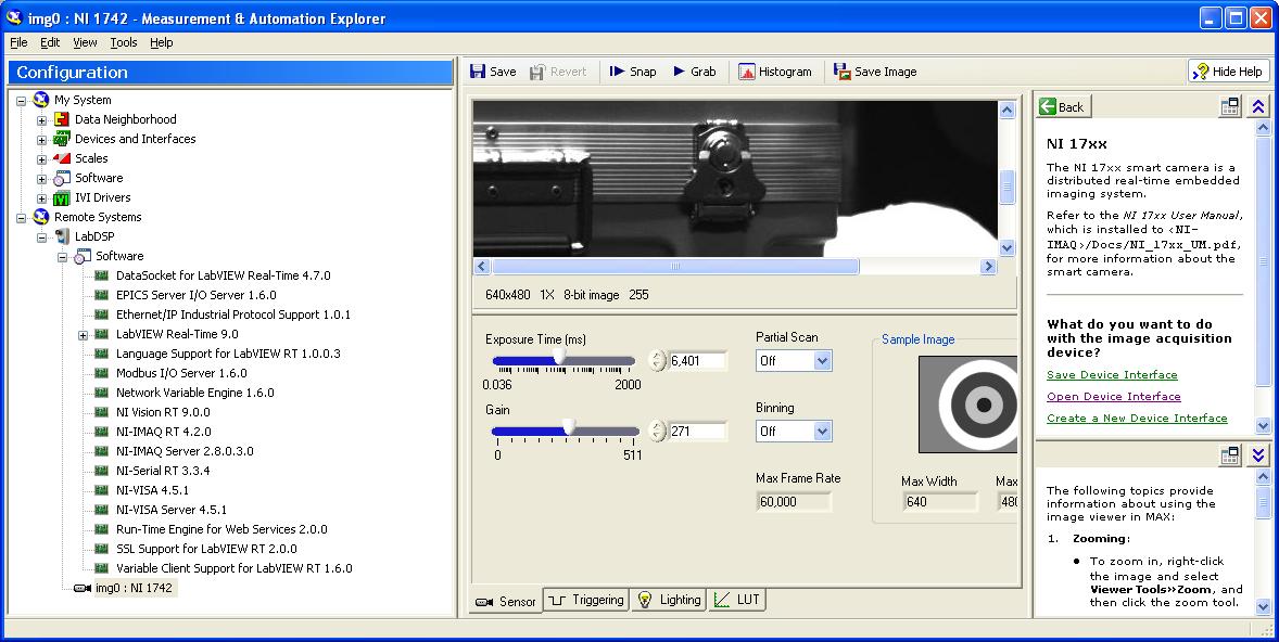

Hi Kristen, thanks for your comments. Guess what? This morning (10-may) I updated the software of the Smart Camera, I chose update everything, I unistalled Vision Builder and Language Support for LabVIEW and everything is up-to-date:
Even so, I can't add the Camera as a Target or Devices because it doesn't appears in the Add Targets and Devices window. I'm feeling a little bit dissapointed about this.
I was watching at this page:Add targets and devices dialog box and I don't have the option of Add device on remote subnet, I guess I need this because I have the Smart Camera connected through ethernet.What do you think about it?
Thank you so much for your help.
