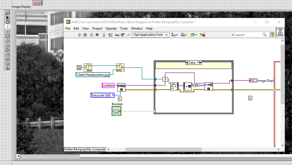

This example is exactly what I want to do, and works on my computer beautifully.
https://forums.ni.com/t5/Example-Programs/How-to-use-the-IMAQ-quot-Get-Last-Event-quot-property/ta-p...
As my image is in a VI in a subpanel I wrapped the above example in a subpanel and it still works.

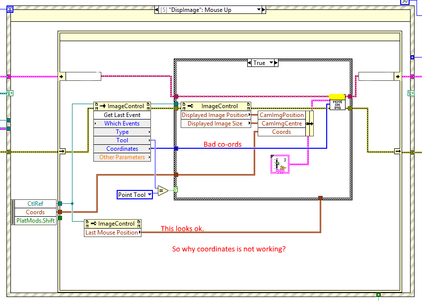

However when I try to use this in my application it doesn't work with the mouse up event.

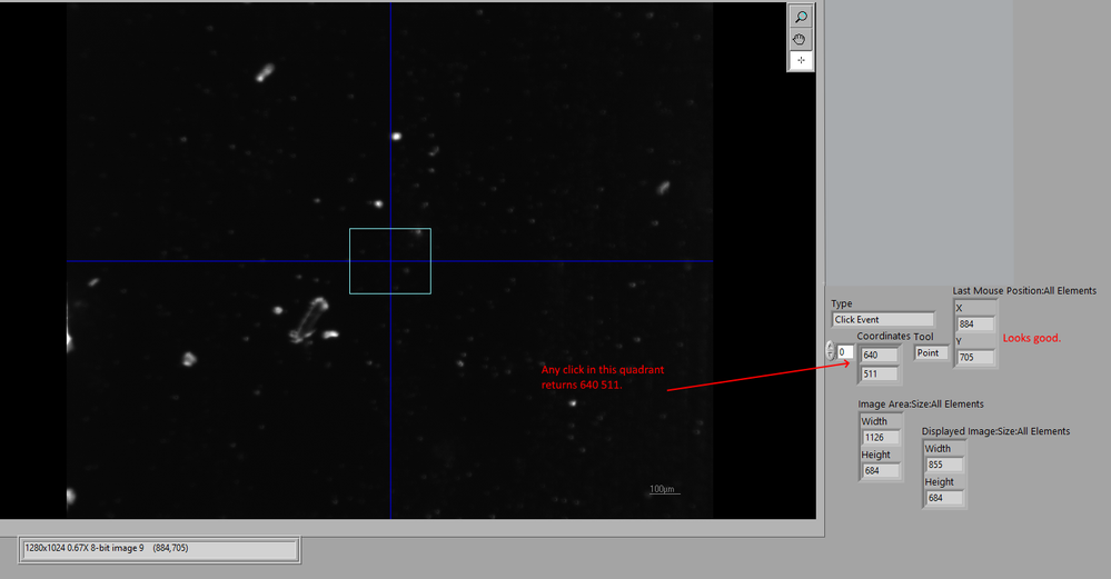

My image size is 1280 x 1024.
The point click event returns one of 4 values pairs depending on the quadrant clicked [0,0]  [640,0]  [0,511] or [640,511]. Interesting this is 1/2 image size.
Mouse location returns corrects co-ordinates. Zoom tool returns correct co-ordinates. So not sure what is wrong.
Any suggestions?
 I will use mouse location in the meantime as its probably close enough, but it would be nice to know why the coordinates event is not working.

Confirmed its not due to IMAQ Array to Image... which is how I am loading the camera data in the program.
IMAQ JPEG Load.pngDisplay image is the only control with a mouse event in my application. So can't see how other events should be confusing it.

After some testing the Last Mouse Position is more accurate than what we had, but I think it would be better to use the event coordinates if I could get it working properly.
