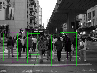

can you try the attached image (taken from online pedestrian database) with the following values:
and see if you get the same results:
K
https://decibel.ni.com/content/blogs/kl3m3n
"Kudos: Users may give one another Kudos on the forums for posts that they found particularly helpful or insightful."
Message 18 of 24
(3,061 Views)
Dear Klemen,
the labview vi worked perfectly but without specifying the image path,when i put any other image path i receive the same image you had posted (the first one)
any ideas?
Thank you
