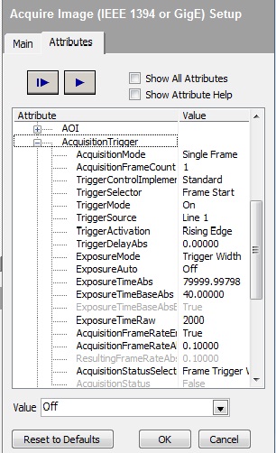

Hi David, the inspection was running well but strangely something went wrong as i mentioned before i take hardware trigger from PLC to trigger the Camera and the light at the time and supposedly the camera takes one image per trigger but the camera now acquires video that was the setting of acquisition and it was working well before in first attachment.
 i tried to solve this issue by changing these settings first try as shown in the second attachment
but the camera is giving me fail as shown.
the best thing i got is with the setting in the fourth attachment
but alas it`s not fully synchronized with the PLC pulse
Hope finding what`s the problem and its solution.

The Trigger selector has unique settings for each selector value. So you may have multiple triggers configured for each trigger selector. You want to make sure the trigger mode is off for all thee trigger selectors except Frame Trigger...this is the only one you want to turn on for trigger mode.
Hope that works for you.

Thanks Brad! that worked for me
