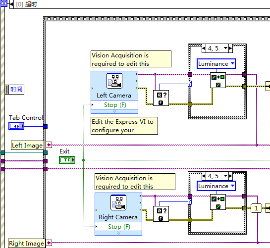

I'm working with two basler cameras and i need to find 3d coordinates of an object. I found out that i shoud use stereo vision library, but it doesn't work as i expected.
I tried to calibrate stereo vision system using Calibrate Stereo Vision System.vi, but after i configured two Vision Express VIs to grab from my cameras, i still get an error that says that i need to configure to grab from two diffrent cameras.

I suggest you use probe to find out the real error as picture followed2014-05-19_205230.png
It maybe you couldn`t connect to your camera. Do you use GigE Vision camera? Remember close your fireware!

no, im using two Camera Link Basler acA2040-kc cameras

Do you use probe  after vision acquisition express VI to detect the real error?
