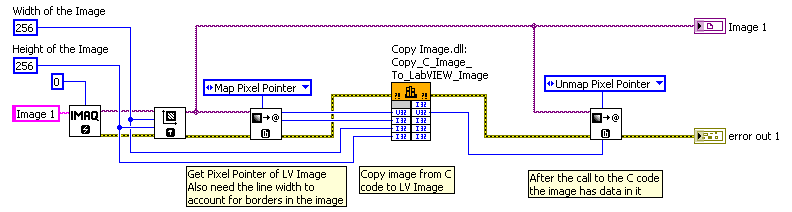

Hi, Greg,
Thank you for the answer. Let me explain my question.
When I need to make some calculation inside of the DLL, then recommended way looks like this (got it from NI Help):
According C code should be:
I don't like such method, because for each image I must transfer to the DLL: pointer, width, height, linewidth, etc.
I prefer more simple way:
Now I will obtain all image parameters inside of my DLL code, and I have only single argument instead of multiple:
But now I'm not sure - probably I must "isolate" direct usage of the pointer (imageStart member of the ImageInfo) with Map/Unmap calls? Probably MapPixelPointer will "lock" pointer and will prevent relocation of the image in the memory in LabVIEW during LLB call, or something like this... Or given code is safe? This is why I'm asking about detailed explanation of UnMap function.

Andrey -
Ah, I see what you're doing.  While this isn't officially supported, it seems very unlikely that doing things like this would stop working in the future, and you don't need the MapPixelPointer and UnmapPixelPointer calls in the C code.
Additionally (just to be clear), in the C code you can treat the LVImage as a normal Image* and call imaqSetImageSize(), imaqFillImage() etc. on it without the need for an extra testImage.
Good luck in your application!
