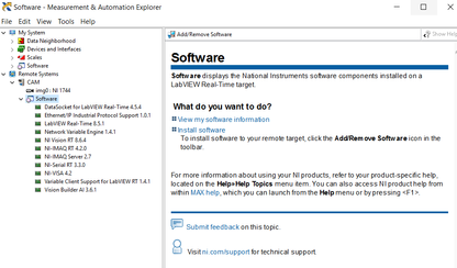

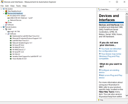

Hello, I'm using a NI 1744 Smart Camera and I've connected it to my network's modem. After doing this MAX now detects it in the Remote Systems Tab as shown in the image.
When i search for the interface name it says that it is "img0". Now I go into LabVIEW and use IMAQ to get some video.

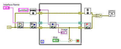

And then i get the following error:
I don't understand why this error is happening, I already tried changing the interface name, entering img0::0, and even using IMAQdx (I know it's not meant for NI cameras but i had to try).

Are you running the VI in the context of a LabVIEW Real-Time project? I can't tell from your screenshots but that error is expected behavior if you just run that VI on Windows. It will look for img0 on your Windows system and it won't find it. You'll need to create a new project and add the 1744 as a real-time target and then deploy the VI to the smart camera.

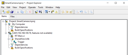

I got the camera inside a project, and tried to deploy the VI inside the camera.
But the VI inside the camera, has no controls or functions available in the palettes, and there's also that text next to the IP address that says "features not available". I tried reinstalling the Real-Time module, but the problem persisted. I wonder what is causing this issue.

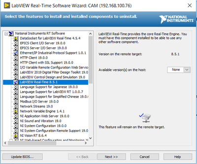

I ran the Real-Time install, rebooted, ran the Visual Acquisition Software install, rebooted, and the problem persists. I´m starting to think it has something to do with the version of LabVIEW RT dowloaded in the camera.

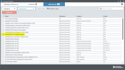

I tried to update the software inside the Camera.
But even though the NI package manager says i got LabVIEW RT 2019 installed, it doesn´t give me the option to update the software inside the camera.
