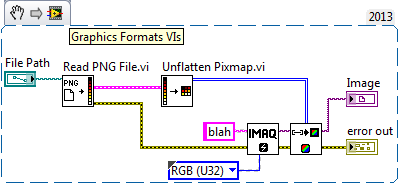

Confirmation: Your code produces error code -1074395993 when executing "IMAQ ReadFile" when reading this png. I don't know what might be the issue of with this PNG. As a workaround you might want to use "Read PNG File" from the "Graphics Formats VIs" which does not have this issue.

Solved using "Read PNG File.vi" just as in the example above.
