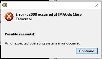

I'm using the NI-IMAQdx vision USB 3 vision device driver. I just update the NI vision acquisition software to Feb-2016 version. However, when I run the script, it gave me another error whoen here.  Does that mean I have some issues in the Win 10 operating system?

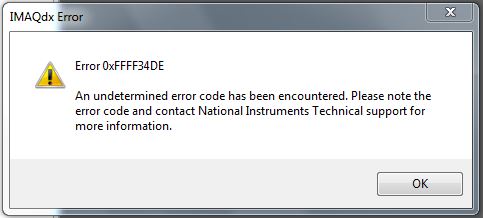

I found that win 10 isn't compile with some drivers I have to use, so I just rolled the computer back to win 7. All the other issues of drivers were cleaned after that. However the issue with the IMAQdx comes more. Now, I can see all the cameras recognized in NI MAX, but when I tried to get the signal from the camera. I have this followling error:
I think this should be the issue of one module in Labview, but I'm not sure which one I should start to check and update.
