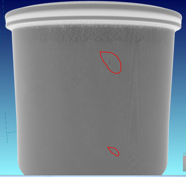

Going to try to get to the crcor this week.  In the meantime, Here is an illustration of the unwrap/reslice process so you can understand it.  I have a series of slice images (think about using a knife to cut horizontally thru the body of a cylinder/tube with one of the open ends up so that you are actually cutting out circles) from X-ray computed tomography.  These slice images are used to form a volume rendering like so:

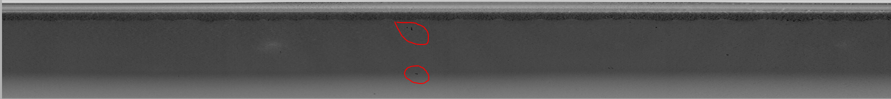

Now I want to "unwrap" the volume in order to look at the whole volume in one view, and because the wall has a thickness to it, I want to look at essentially one-pixel sheets of the wall as I move from exterior diamter to interior diameter.  Here is one of those unwrapped sheets about mid-way thru the wall:
You can see the circled flaws in both images, and you can see that unwrapping the image makes it easier to see everything at once (there are many more flaws as can be seen) vs. rotating the volume (which we also do - we create AVIs with rotations and zooming).

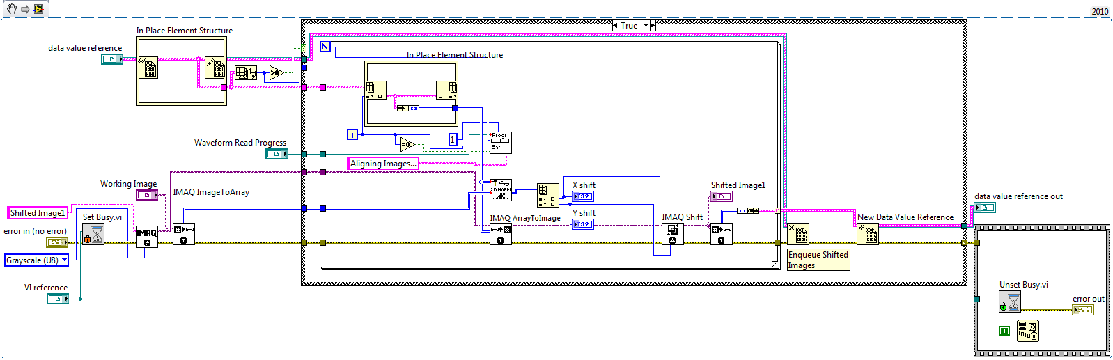

I am sorry it took me so long to get back to you regarding the use of your normalized cross-correlation routine for this application.  I was tied up with other aspects of this project.
Here is how I implented the code.  I believe I implemented it properly (please comment if I did not).  Don't worry about the data value references.  I am doing things in RAM so I created a data value reference for the stack of images.
Here is the result of the cross-correlation routine:
So we see that I get the horizontal striping with this routine as we do for the earlier shifting strategies that I tried.
I think the next step is to try to code up the Rigid Body Transformation from the Java code or other references.

Folks - I had one unneeded portion of code in the snippet I showed in the last post so I am showing the corrected code here.  Basically, I had a subtraction from a reference point that was not needed, and really incorrect.  However, the end result using normalized cross-correlation for image registration/alignment still reveals the horizontal striping.
